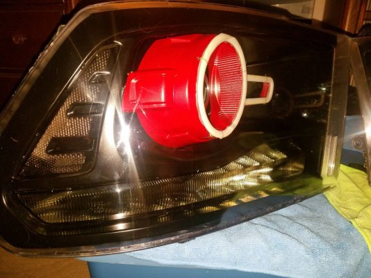

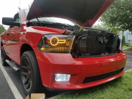

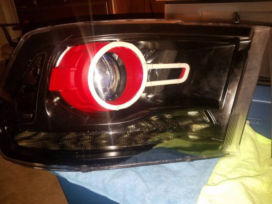

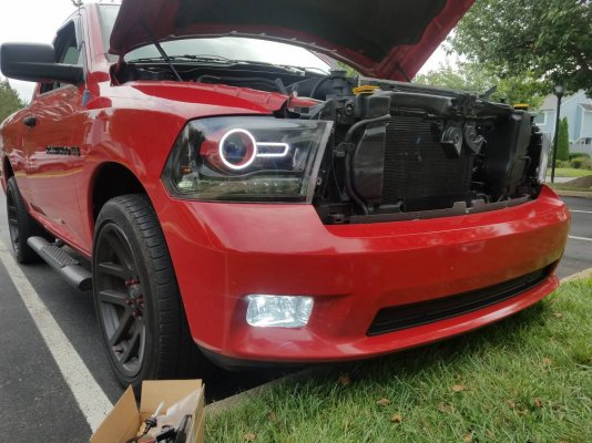

If your going with the TYC OEM Projectors, the led boards are mounted differently then the OEM version and any of the clear/smoked DRL lenses and clear/smoked clear corners will need to be customized to get them to fit.
I just built myself a custom set of TYC OEM projectors and I had to customize alot of **** because it was slightly different then how the OEM projectors were designed inside.
