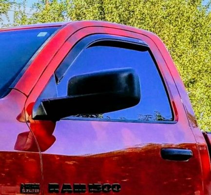

And my 2012 Reg Cab came with these:7838fdad5f4d88d4cae2e718c657116d.jpg
Now mine ARE power adjustable and Heated.
So my question is, if I buy a set of 2012 OEM Ram 1500 mirrors with Turn Signals and Puddle Lights will they be a direct plug and play? Will the harnesses and plugs be in there somewhere?

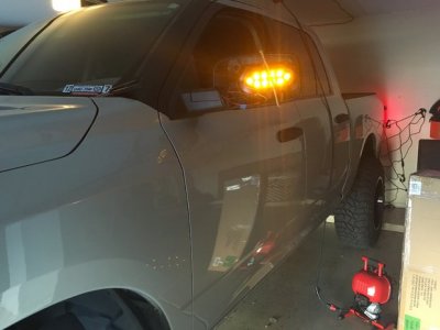

Ya mine are hard wired to my front turn signals...I almost stopped half way through the process because it was such a _itch lol

Mock setup...
