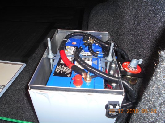

Plus the added level of anti-theft when they're disconnected.
Now thats a good point,lol. When i'm staying at a hotel with the truck,i always turn both disconnect switches off on it,with the idea they'll move onto something else that's easier to steal. The one in the back bumper is to make the truck NHRA legal,as it shuts the truck down,but doesn't kill the whole electrical system,the other one on the battery box kills everything on the truck .
