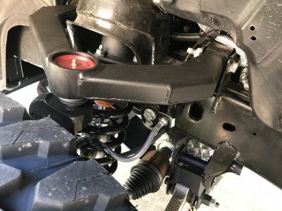

I also added the Zone arms with my lift, my truck had 1200 miles on it. If you have the money in your budget they are nice to have. They aren’t required, but you can add them if you want for added strength.
Here’s mine

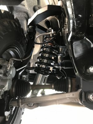

I just had my bilsteins moved up from 2.1 to 2.8, installed mevo uca's, icon 1.5" springs, and bils in the rear. I know I didn't have to replace the uca's, but I figured for less that $100, why not replace them.

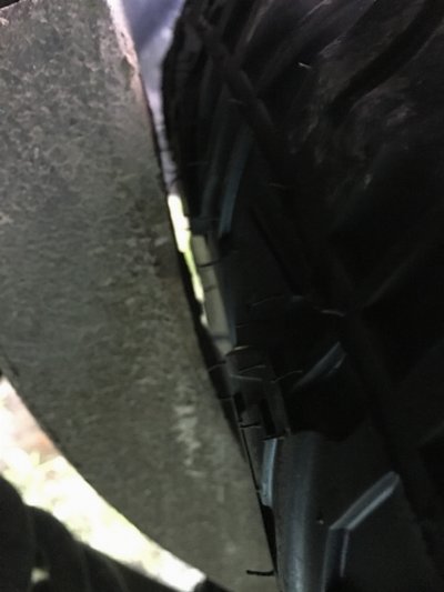

The 1/4” spacers will depend on your tire and wheel choice.
With a 6”RCX lift and 35x12.5’s on the stock 20” chrome clad wheels, I needed the spacers just to keep the tires from rubbing on the knuckles.
Here’s a pic for reference. This is WITH the 1/4” spacer.
If you run a narrower tire, or different wheels with less back space, then the spacers may not be needed.
