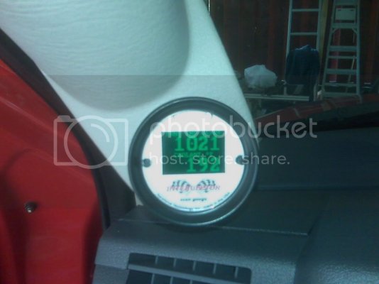

Any suggestions? I want to run this gauge....
Auto Meter

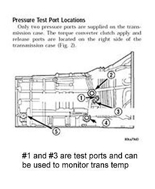

You can hook a gauge up to the test port on your trans. Use an autometer 3280 1/8 to 1/16 adapter and an autometer 2259 temp sender to hook up just about any gauge.
