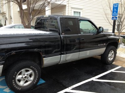

Hi guys,
My other cars have been Nissan's and this is my first American made car and my first Dodge truck: 1999 1500 Ram 5.9 4x4 quad cab 167K miles. I purchased this guy about 2 weeks ago at an auction for about $1K and I already put a good $200-400 on parts and fluids, to give some background I think the car has been sitting for a year or maybe two.

Can you tell me if the vehicle has been lifted? It seems to me that it has been lifted maybe 2" off the ground. I would like to asses the steering and suspension parts.
pics below
Thanks in advanced.

3. Looks like a leveling kit in the front. Look in the wheel well, at the coil spring, is there a puck type deal at the top? If so leveling kit. It does look a little taller then stock.
