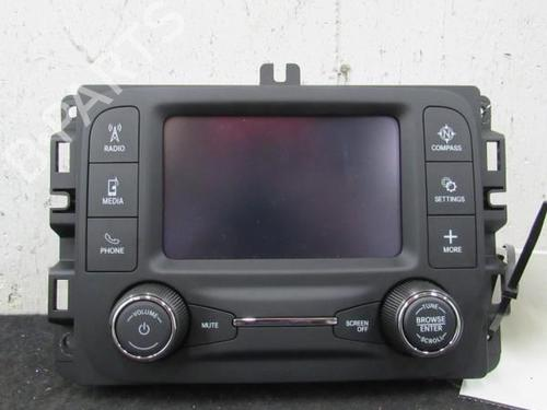

If your radio, has a Satellite button on it, then you have Big Brother
If on the other hand, you have
Compatible Vehicle Information​
Years: 2019, 2020, 2021, 2022, 2023, 2024, 2025
Make: RAM
Model: Truck
Stereo: With UConnect 3.0 with 5" Screen
Connection Type: Factory USB Port
You would need to buy a KIT to have Satellite
If you do not have a 911 button on your mirror, you do not have an AIR CARD connected to your radio, it also operates as Big Brother
It is a direct phone connection to RAM Headquarters & Emergency Services
5.0'' SCREEN / 68490431AA & AB
  • [2021-2023] DODGE / RAM 1500 PICKUP - classic style (5 lug wheel), display and receiver, 5.0" screen (Uconnect 3), w/o satellite radio
