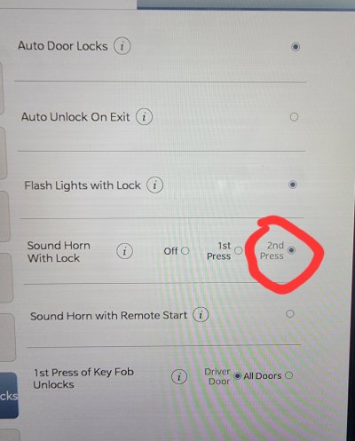

Hey everyone, my 2022 Ram Longhorn recently stopped sounding my horn when I double press the key fob when locking the doors. That option is selected on the menu...any suggestions? Thanks

Try turning the horn option off for a few drive cycles and then turning it back on.

Okay guys first I turned it off for a few Cycles and then I turned the second press option and it did not work. So I went to the one press of the key fob option and it would work, then I turned it back to the two press option and now it's working as it should. I learned something new. Thanks for the help

Glad you got it working.
