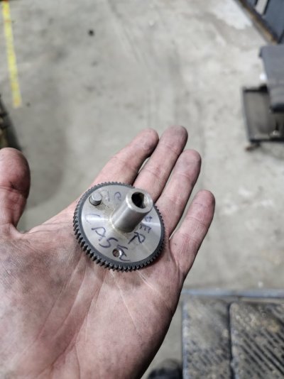

I blew out my OEM Transfer Case Motor ******* around last week in some mud testing out new tires :cool:. ( I got stuck in 4 Low when the magnet delaminated inside the motor. )
That in itself is an easy fix, Just pull the motor and turn the chuck clockwise to get back to 2WD.
Today the Dorman 600-908 showed up. Hoping this one will last 10y as well...
Its a super easy swap. The pin is super easy to pull and reinstall as well. The only down side of this whole thing is the price tag of this part... 170$ for a Dorman part is something I never thought Id see in my lifetime...lol...

How many times did you have to turn the stub shaft clock wise for the new doorman
It was so long ago I don't remember. But make sure to pull this part out of the old one. You can use it as a tool to trun the T-Case :anitoof:

I put the T-Case switch in 2wd and made sure my T-case was also in 2wd with the tool I made ripping the old motor appart. ;)
Had my buddy play with the 4x4 switch while I was under the truck to make sure all the positions worked on the new motor as well. And had that in 2wd when installing.
If all 3 are in 2WD that triangle spline should line right up.
