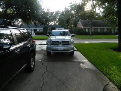

Promised pics Dirty truck!

She looks like a fat girl with little feet from the front. What about wheel spacers?

I like your truck, I don't think it looks like a fat girl with little feet, it looks stuffed, looks great as is, imo.
I would get negative offset wheels before I ran spacers though.
