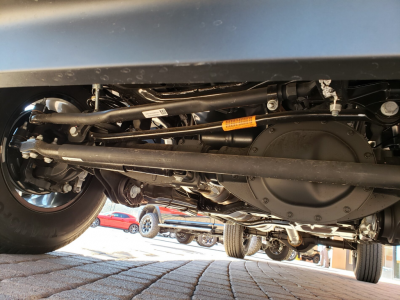

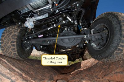

Can you post of pic of your drag link and does anyone have pics of old and new drag link?

I don't have a picture of the new one but the old one looks like below with the jam nuts. New one is a "pinch" style clamp. The old one were only on the 2013-2017 (or 18?) trucks. So not a worry for you guys with the 5th gen trucks, they have the new version.
This was the "fix" for the older ones, welding it....

Old style
New style
not the issue you’re experiencing it sounds like
