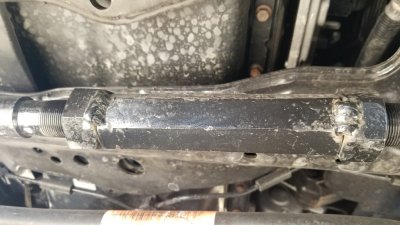

Yeah ramcares just picks random people to help out with this drag link issue. The dealership had to weld mine the day before I bought my truck and I was told at a later date there would be another recall on it to fix it correctly...... a bunch of BS. With the nut welded there’s no way to center the steering wheel during an alignment! So now every time we have an alignment done we get to pay extra for the alignment shop to cut the weld and then re-weld it. Also every time that drag link is welded on it is weakened!!!!!!! I tried to contact ramcares about getting my drag link replaced with the newer style but I couldn’t get a reply from them. I don’t understand how they can get by with just replacing a few of them for certain people??!??! If they are willing to replace any of them then that means that they know, and acknowledge, the original recall didn’t actually fix the problem and they’ve left 99% of their trucks out on the road with an unsafe drag link!

18CrewDually
Nov 17, 2019
2,421
3,414
U.S.- New Jersey
Cummins 6.7 H.O.
For anyone wondering this is what it will look like after they do the recall. The first sign of wear on the tie rod end I'll probably just get the newer 2019+ version like they put on my father's 2018 3500.
