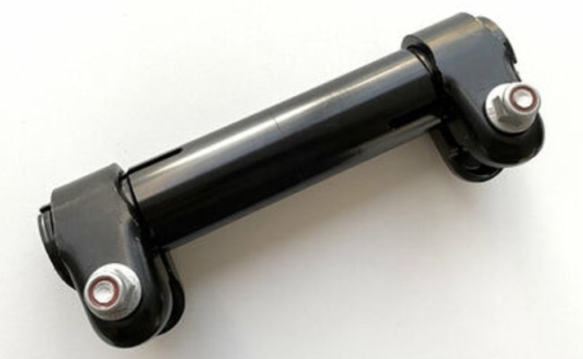

For over a year now for $120 you can buy a new adjuster sleeve.
Pick one up and have your shop swap it out if you can't handle it yourself.
Here's a video of the install. OK4wd has them.
