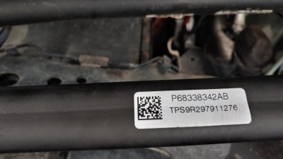

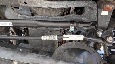

I had mine replaced last week with the new updated part. I refused to have mine welded and FCA reached out to me and offered to replace it. It was a long frustrating process but it eventually got replaced.
