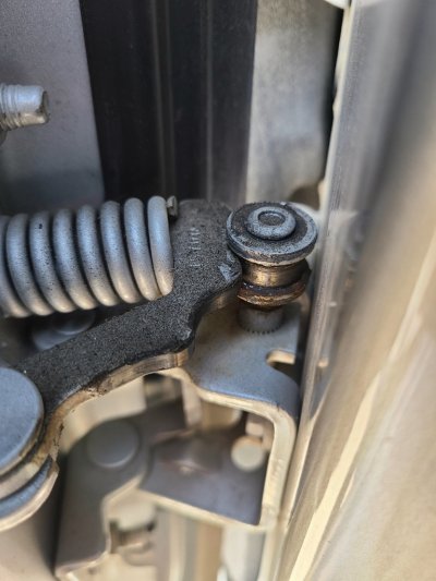

Mine have done it a couple of times. First time i used Lithium grease on the spring and hinge, 2nd time i put a little dab of marine grease on the hinge. Have held up great so if it happens again i'll do grease again. Last time i bothered with it i think was the begining of the year so the door has stayed quiet since then.

I have plenty of greese, but where exactly are you guys applying this lube?
The only way I can get it to stop is by using a nozzle and spraying/squirting it directly in the top of the bushing and even then it only last for a couple of months. Nothing else worked for me.

Had the issue on my 11’. Used 3in1 oil and did a few drops on top of the roller and let it soak in. Opened and closed the door (just short of latching) and noise vanished. The issue is inside that roller bushing.
