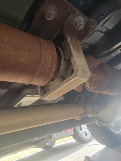

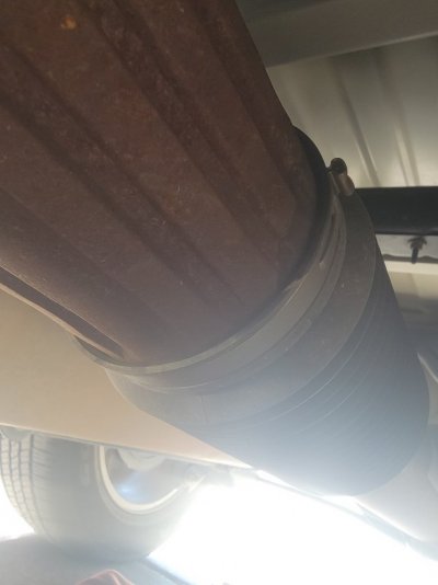

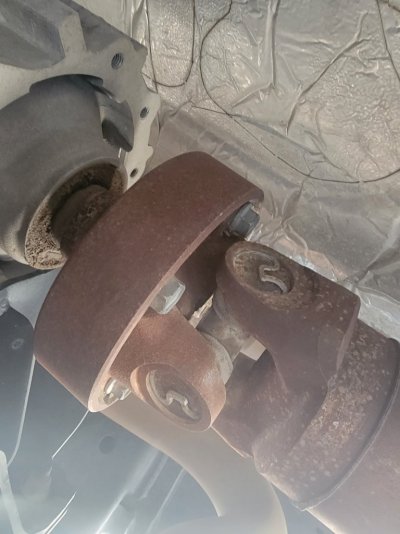

I've got a 2019 3.6l I'm pretty sure mines a 2 piece steel driveshaft. I'm not to knowledgeable with trucks but I'm learning. I get the clunk right after I come to a stop and right after I let go of the brake to go. I'm going to try to attach some photos maybe yall can tell me if this looks off. To me it does, especially with the year of the vehicle. Also in-between some of the parts where it joints together it had a lot of like sand build up. I stuck my finger around in it and a bunch of stuff dropped down that looked like sand just a bit thicker of a texture almost like kinetic sand how it just molds together. I haven't taken my truck in yet, I'm getting a growing list of **** that keeps happening.
