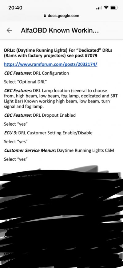

The CSM option(last option) is the option to enable the toggle of your radio.
JB1
Nov 3, 2011
8,366
7,542
Houston, Texas
OBDgenie can’t do it, your dealership can’t do it, but you can do it in your driveway in about 5 min....AlfaOBD is a game changer
Here’s my 2017 screenshot

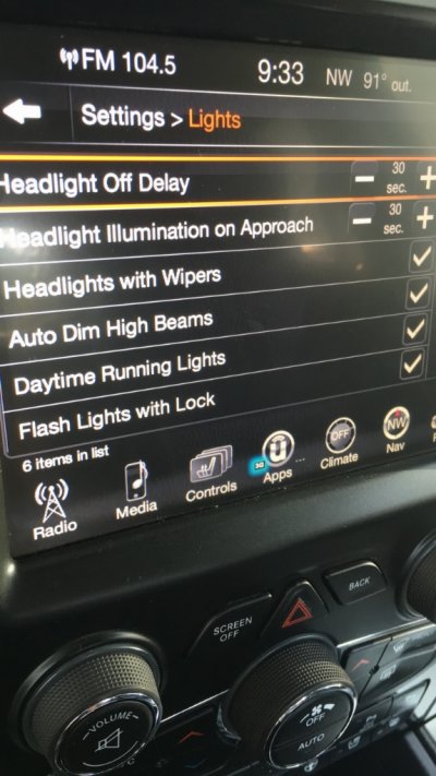

Thanks for everyone who pointed out alfaobd to me and that DRLs can be toggled on 15+ rams. Finally got my feet wet with alfaobd with all the help this forum provides. You guys rock!
