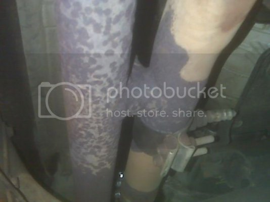

Edit to add photo's
Twin magnaflow Cats
Single **** 2.25 DI/DO Magnaflow
Old system showing the front H
Side dump
Old system dual flowmaster 44’s
Rear H old system

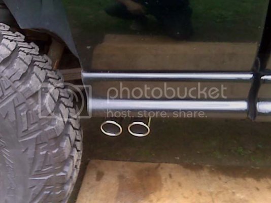

For a side exhaust, could get big tips as well. Heres my old single side pipe:
Merc, that stainless exhaust is just sexy. Lol.
