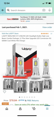

Does anyone know if your dust cap will go back over an aftermarket Led headlight (high beam bulb) once installed? The lasfit mini led bulb to be exact. Thanks

Does anyone have experience with the lc plus series from lasfit?
