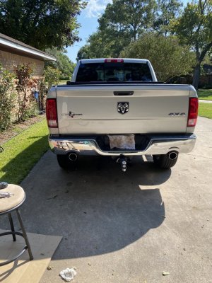

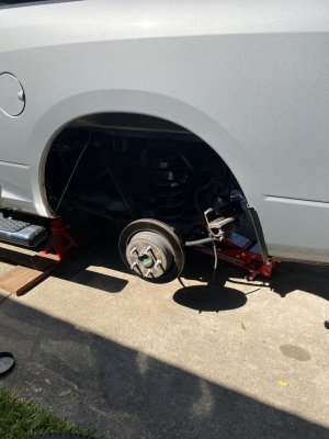

Before installing rear shocks and springs I was at approx. (with full tank of fuel and no extras);
LF – 36-1/4”, RF - 36-1/2", LR - 39-1/8" and RR - 39-3/8"
After installing rears shocks and springs only;
LR - 40-1/8", RR - 40-9/16"
What the heck?? 1/2" difference, between left and right???
I guess I have to tear it all down and try to reorient the springs a little. I noticed as I rotated the right spring a little more clockwise than the oem was sitting, it improved the seating as well as seemed to rise a little. I guess I have to rotate it about a quarter turn back counter clockwise...
The only difficulties were the driver's side top shock bolt and the lug nuts felt like they were impacted at 1,000 lbs. Got to love those tire rotation "technicians".

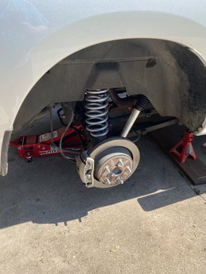

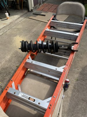

LF - 39-1/2", RF - 39-15/16", LR - 40-1/8", RR - 40-9/16"
Directly After I installed the fronts, they were hovering about 41". I was pretty excited. Took her for a spin - got her out on the hiway, etc. She dropped to the above. I haven't remeasured the rear. But, I imagine they settled in some. The truck looks completely level to me. So, I want to get a little rake back. I'm going to try and find a 3/4" to 1" top coil spacer for the rear.
I thought I broke a cv during the install, from cranking down on the lower control arm to get all the bolts back in. I removed the cv boot, did a visual inspection, mostly just saw grease. LOL So I stuck my fingers all in there. Couldn't feel anything unusual, resealed the boot with a stainless hose clamp. Then did the drive around.

Looks great, did you go with the second ring?
The Rams look nose high even when they measure level, worse if you have a sport hood.

Looks great! Hows it ride?!
I agree. The rams need about 3/4-1” higher fenders in the back or they look like they are sagging ass.

Rides good. Now I've done alignment.
Before;
After Install and drive around the block;
After alignment and 100 or so miles;
LF - 39-1/16", RF - 39-1/2", LR - 40-7/16", RR - 40-13/16"
Unexplainable - seems the rear "sprang up" a bit?

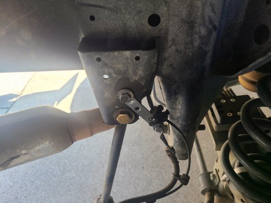

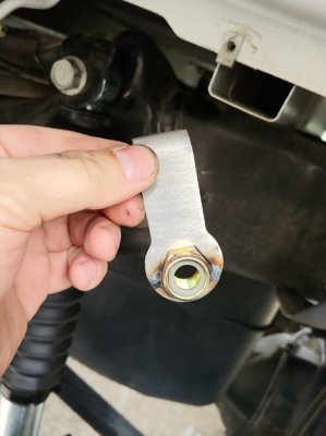

Just add a little extension bracket to where the original brake line brackets mount. It's only like $3 and you won't have to mess with your brake lines unless you want to upgrade to steel lines. Don't know why but there was no shop that will touch my chit when i asked them how much to extend my brake lines with aftermarket ones. Brake hoses and disconnecting brake hoses from the hydraulics is one of the things ive never ever done and so i'll pay to have it done as needed but damn nobody will do it at least around a 30 miles radius :)
This were my original extension brackets for 27" shocks
50310287712_50e4a5fcab_h.jpg2020-09-05_05-44-20 by
RAM RSM, on Flickr
This is a longer version for the 28.75" rear shocks i run now.
50433592567_9326b4207b_h.jpg2020-10-07_01-58-34 by RAM RSM, on Flickr
50433423936_03e8510afa_h.jpg2020-10-07_01-58-46 by RAM RSM, on Flickr
