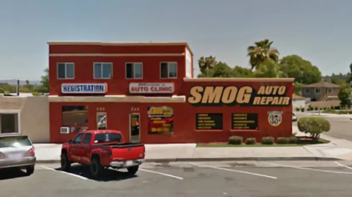

Down here in California, our Emissions Rules are strict
We have a rule that when the 6th year of ownership TAGS are due, we had to have ALL Emissions lights had to be OFF.
The only things that would not pass was the
HIGH PRESSURE FUEL PUMP,
We had to take a FORM to the dealership, it stated that the
HPFP Mopar Part is NOT available & would not be available in the foreseeable future.
I did not go through a DMV Office, i got the form from one of the Independent Licensed DMV Partner stores that California has in most towns & villages throughout the DMV.
The regular DMV Offices have lines that wind around the building
I took that paperwork to one of the private auto Registration offices & they took care of doing what the official DMV needed for me to get the proper registration.
