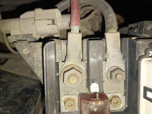

Well it's gotta be something else.... Any help would be great... I am on my 3rd ECU and I can't drive more than 1 mile before my check gauges light comes on and my volts drop.... HELP
