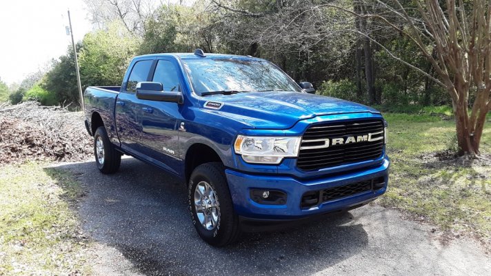

I am glad I picked up my Bighorn (2019) for 50k,, MSRP was 65k...I never pay sticker for anything!
