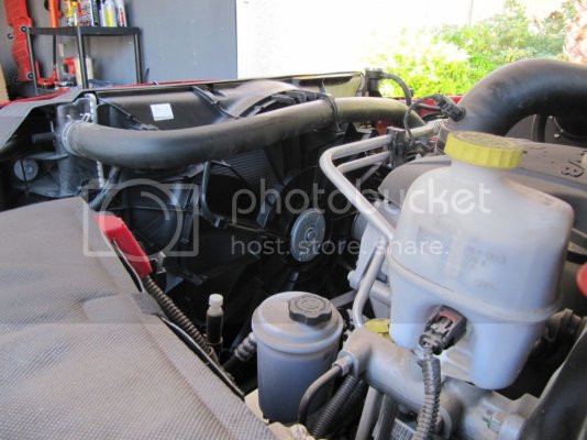

Alright install is done!!!
Start to finish, not including the clutch fan because the dealer removed it, it only took me about 15-20 minutes to swap the parts. Probably would only have taken 5 if I knew what I was doing :p
Alright, here's the DIY..please let me know what you think and if you have any questions, feel free to ask
But here's a few pic's of the install
