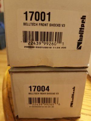

You can see the rear shocks are double valve and the front single. Everyingthing else is the same as the reg kit.
5317
4762
5553
Panhard relocation
I hope to get it in next weekend.

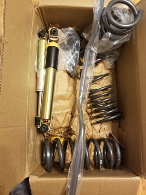

Yep, front you can adjustable compression, rear compression and rebound. Wish it was a 2/3, I tow to much for a 2/4.
RTnoob
Mar 30, 2019
35
Tx
A little to low in the rear for me. Going to put some GF 2" I have in. Make it a 2/2, kit took about 2 and a half hrs to put in. Not bad
