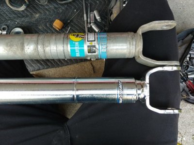

Hey Hodge, I just came to the realization that I'm going to need parts for my install. I turfed my OEM coils not thinking I'd ever need them. Now I'm going to have to find some bottom coil seats and jounce bumpers as the 6112's components aren't compatible. I can't for the life of me find the part # for those seats.....any idea?
Also do you think I can reuse the top mount spring isolator assembly?
Cheers
kurek
Aug 7, 2019
2,662
3,815
Northwest
As far as I can tell nobody manufactures a lower spring seat compatible with the OEM one.
There's the lower seat that ProComp makes, but it's not at the same elevation relative to the snap ring so it would necessarily lift or lower if you used it on a different 2" shock body that was channeled for OE seats.
Your best bet if you need lower seats is to order a couple OEM take-off shocks on ebay, steal the seats and then see if you can re-unload them to somebody who just needs to replace their shocks. Yes that's dumb, but also yes that's the exact thing Bilstein suggested to me when I asked them so it's their dumb not my dumb.
Cheers
As Kurek mentioned, you're stuck trying to find a cheap set of front oem struts for the spring seat. The top hat's and all that hardware are the same so you're good there using the new stuff off your 6112s.
It would make life much easier if they had a seat that paired with the struts instead of using oem stuff.
Sent from my SM-N920V using Tapatalk

Bummer! Thanks for the info though. I just called my local Dodge dealership and they said they'd put aside the next pair that comes out of a Ram and I can "steal" the seats...... mighty nicel of them I must say.
