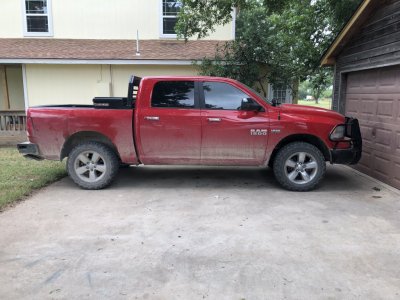

That's the same as the ones I'm running. Finally got the alignment this morning and they do ride a lot nicer than the stock ones with that bumper. Seems like the front actually came up a bit since the camber was bad... really bad. Final rough measurements (My concrete ain't that level) are 39.5" front 40.75" rear. That's with the Eibachs on ring #3 of my front 5100s and the rear Bilstein springs + the .75" TGC top spacer. I'm pretty pleased with it since I still have enough rake to not be too bad when I use it as a truck and rides a ton better than it did.
