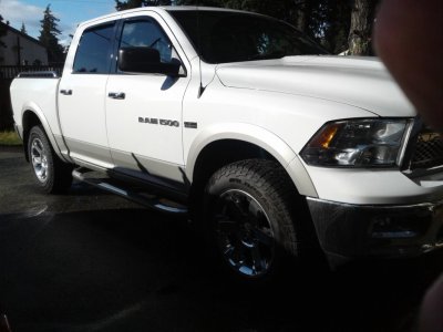

Finally got my kit in at 2 3/4" setting, not sure of stock measurements as there was Daystar spacers front and rear, I gained about an inch all around.
Measurements now are FR 38 7/8", FL 39", RR 40 5/8", RL 40 5/8".
I'll see how this does, maybe I'll look at getting a Zone UCA and diff drop kit and bump it up to the 3 1/2" notch. But so far I'm pretty happy.
