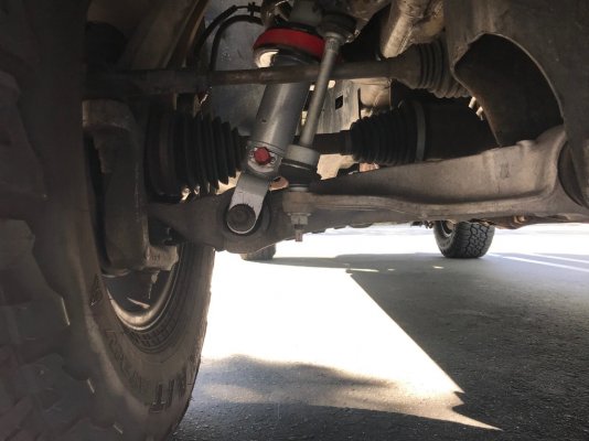

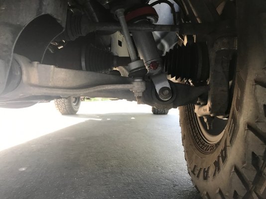

from my understanding if you buy the strut with the coils the minimum lift is 2.75", if you don't buy the coils then you have more settings.
Instructions with coils
https://eibach.com/us/pdf/14965
Instructions without coils
https://eibach.com/us/pdf/14963
@4eyedconekiller JB1 found the instruction with adjustable struts and coils. If you look, it says 2nd ring for replacement bumpers, (extra height needed).
So, since you have the Bilsteins already, you’d order the Eibach Pro Springs, replace the factory springs and adjust the Bils down to the 2nd notch which it says would be 3.5”.. probably would need a 1” rear spacer.
Something to check out.
