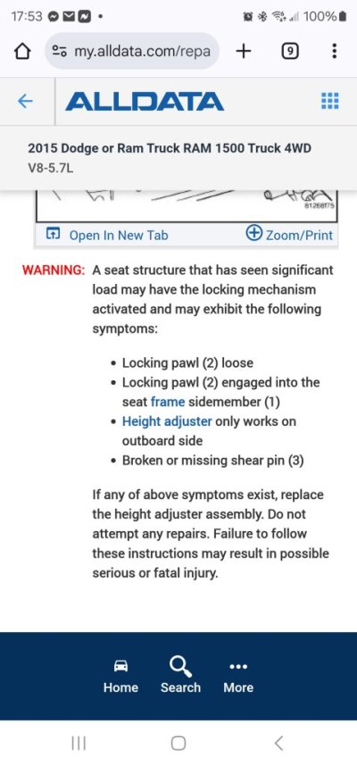

I've got a 2018 Ram 1500 LIMITED with the electric seats. When I accelerate it rocks backwards, and then forward when I brake. The base is firmly bolted to the floor so that's not the problem, and it's the whole seat (base and backrest) that rocks as a whole. I previously had an identical truck (a 2014 limited) and it had also developed the same problem. I've googled it and read many forums of people with the same problem, but have yet to find someone detailing the exact problem, defective parts, and how to change them. I have two trucks at the moment and I'm thinking of stealing the base and/or parts from the passenger side of the other truck. Was wondering if this will work or not before I do it? I'm hoping someone has some insight into this, and if not then maybe I'll make a detailed write up.
