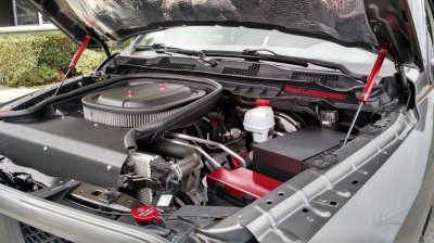

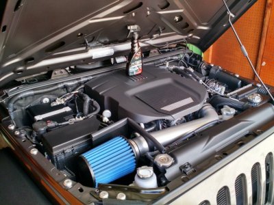

I have always used a detailer spray and micro fiber cloth with good results... I usually detail mine after each wash. Once you get into that rhythm the subsequent cleanings are quick and easy because the detail leaves a film that repels dirt...
I use this for my engine bay, cheap and it works great: https://www.amazon.com/Eagle-One-Sh...0819&sr=8-1&keywords=eagle+one+detailer+spray
Results below, Ram and Jeep. ;)

WOW! That is beyond the results I had in my head. Great work! Do you recommend anything for the initial cleaning? I haven't done much in the bay for 30K miles but once the initial cleaning is done I will definitely be using the detailer and microfiber as you suggested.
Thanks. I would take a bucket of water and car wash soap and give it a good wash... Thereafter the detailer will do the job.
