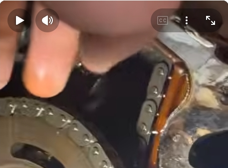

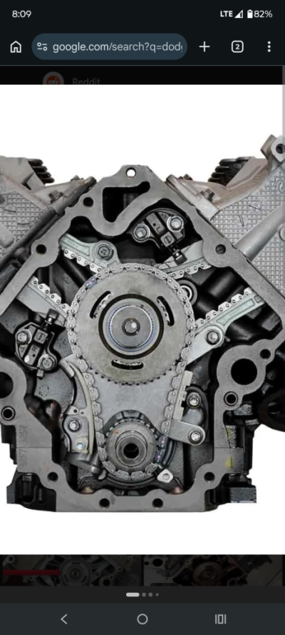

Yea, looks like a 4.7 v8 with a broken or worn out chain guide, or maybe a chain that's stretched beyond the limits of the tensioner.
It should look like this:

That would detonate the engine with valves colliding with the tops of pistons. And that chain looks broken, so there would be no valve movement and the engine would be dead.
The 4.7 v8 is an overhead cam engine with a cam under each valve cover.
There are 3 timing chains. The chain he is pointing at in his video is the passenger side chain that transfers power from the center sprocket to the passenger side overhead cam.
Im not sure what your talking about, with regards to the broken chain.
Are you seeing something that i missed?
Looks like the link rivet on the top is not attached to another link. Not sure what I'm look at then. :oops:

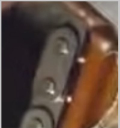

Maybe your monitor requires a tweaking of the brightness, contrast and sharpness settings. :cool:
The source material is marginal for increasing the size, but it sure looks like another link to me.
I think I understand the confusion.
You don't see the next link on the chain because it is obscured beside the engine block casting, where it passes through an opening, to continue up through a corresponding opening in the cylinder head, then the top of the cylinder head and the camshaft sprocket.
On my lap top it looks OK to my old eyes, mind you I damn near got sea sick from the hurry up jerky clip that H posted. slow steady would be better. ;)
