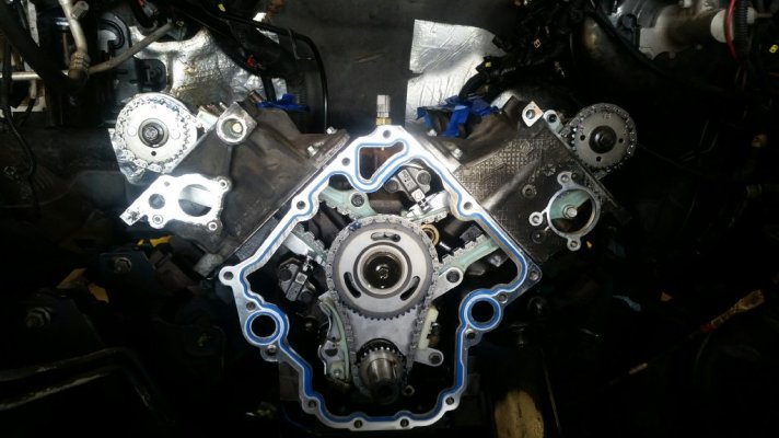

You have a 4.7. It looks like this, basically.
This one is a 2002 JTEC engine, mid-2003 and later have an NGC engine. There is a different tone ring on the crank, and the windows on the cam sprocket are different.
The passenger side chain guide is on the top side of the chain on the left in this photo, it's tensioner is under the left chain, just left of the idler sprocket in the center of the engine.
The driver side tenioner and guide are reversed, tensioner on top, guide on the bottom.
There is also a tensioner and guide for the crankshaft to idler chain located on either side of the chain, tensioner on left, guide on the right in this photo.
