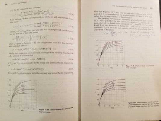

Here you go, OP - only 812 pages to go, excepting the radiation section.20220407_132018.jpg
