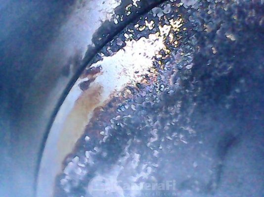

Used to bug me, the best vehicle I ever owned used a solid quart every 3k miles. 11 years no problems used heavily, and I miss that thing a lot. We have done a lot of testing and searching as a forum, hemi395 was incredible in testing. Carbon buildup can cause issues with piston rings, causes oil to blow by. Now, sometimes rings can just rust out and in that case all you can do is use a thicker oil, but if it is carbon buildup ram forum has proven two methods and products through searching and in this case testing it and boroscoping it, that was hemi395. All of our searching and watching boroscopes on youtube, only these 2 methods were effective. No other product in the tank worked like si-1. It will make your oil smell chemically, so it is best used before an oil change. Wait til you run the tank low before changing.
Two choices, run sea foam though the vac lines only, no not in gas tank and not in oil, through vac lines gets it 100% strength right on piston top. See chris fixes boroscope on it youtube.
Then corey did his own test after we seen two others that show redline si-1 boroscoped, all three tests showed it working perfectly, righ on the rings. It slowly melts away the carbon. His boroscope below.
