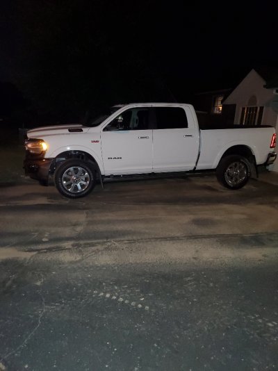

I have a 2020 Ram 2500 with the 6.4 Hemi with less than 6k miles and my check engine light came on last Sunday, of course I was getting ready to go back out on the road in the rig so I was unable to get my truck to the dealer but I have a scheduled service this Saturday for an oil change and to have that light looked at!
Has anyone ever had an issue with the engine light coming on with such low miles with a 6.4 Hemi? I did take a rag and wipe out the area where the fuel nozzle goes as well as the gas cap and re-tightened it but to no avail, the light won't go out! So far no performances issues have been noticed!
Any ideas as to what might be going on and what I could suggest when I get the truck in this Saturday! fd7417cead411b3d3c02444861958a34.jpg
