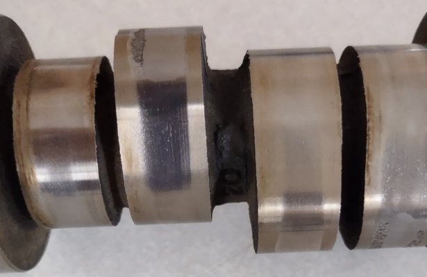

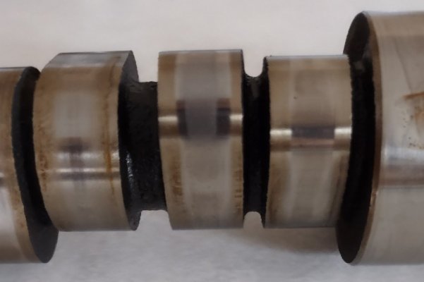

Can't say I've seen one that looks like this before. The only thing I can think of is the lifter wheel rotated. The lifter wheel doesn't really look that bad considering. The lobe next to it shows wear starting on the lobe and the lifter wheel bearings are worse than the one with trough in it. There are 2 other lifters that were going bad too. Definitely going with the MDS Delete.

msedly
Jun 22, 2019
31
15
Charlotte, NC
Mine looked exactly the same when my lifter failed on #1. Roller seized up and the lifter turned 90 degrees.
