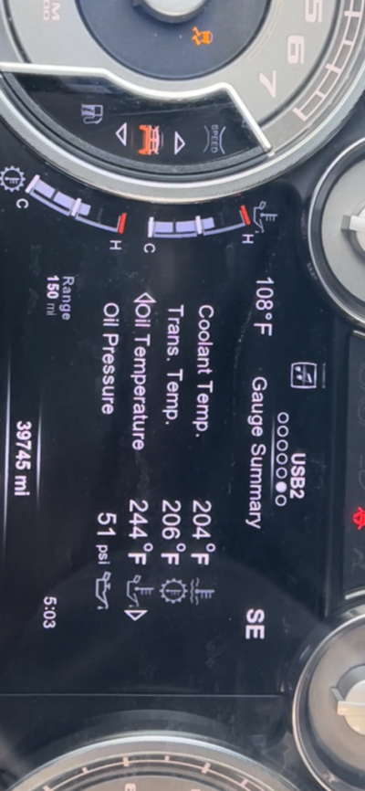

i removed the pos grill shutters one week after ownership installed two pusher fans in its place.. look at this 20 minutes on the freeway i look down this is my temps ...
Your best option might be to move out of the left lane,over to the right lane and slow down. Gotta love them 3.92's at high speeds,lol. If you're outdoor temp is 108F,you might want to stick a 180 thermostat in it for the summer temps,then swap your original 203 thermostat back in for the cooler months.For all it takes to swap t-stats on the trucks,it's an option to consider,along with slowing down,or replacing your 3.92's with 3.21's. The differance in rpm between 3.21's and 3.92's at 90 mph would be like slowing down to 74 mph. The same rpm you turn at 90 mph with 3.92's would put you at 110 mph with 3.21's
Maybe remove the 2 pusher fans. They may be more of a restriction than help. I have the v6 fan and have never seen temps that high. My trans reached 196 as the highest I ever saw after a 3 hour trip on the interstate doing 80mph. 3.92 gears lifted and 35s. I would swap to a 190° tstat as it’s the best of both worlds in my opinion. Cooler than stock. But not so much cooler that the heater feels cooler in the winter (but I’m in Florida. Lol). My rpm’s are right around 2,000 rpm at 75 if I remember correctly
Maybe I’m the odd one but I’ve never had issues with the heat. Maybe it’s my 35s? since my final drive ratio is around 3.55-3.73 with my setup compared to stock. Even stock I think my highest oil temp noted was 230° with the AGS and stock tstat in the middle of summer with mid to upper 90s
Oil temps on the Hemi seem to be directly tied to engine rpm Khris.The faster the engine is spinning,the higher the oil temps will be. Slowing the engine rpm down,is usually the best option to lower oil temps,which means switching to taller gears,or actually driving slower. I agree his pusher fans don't do much for lowering his oil temps though.One option that hasn't been brought up,is to run a totally seperate stand alone thermostatically controlled oil cooler,that ties into the oilpan and uses an electric oil pump to circulate the oil in the pan through a stand alone cooler,totally bypassing the stock oiling system. Years ago,you used to be able to buy finned aluminium oilpans that supposedly helped with oil temps,but i don't know if anybody makes a finned aluminium oil pan for the trucks,similiar to what the cars use.The car 5.7's and 6.4's use a finned aluminium oil pan.
