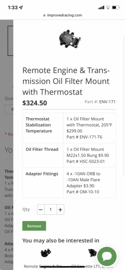

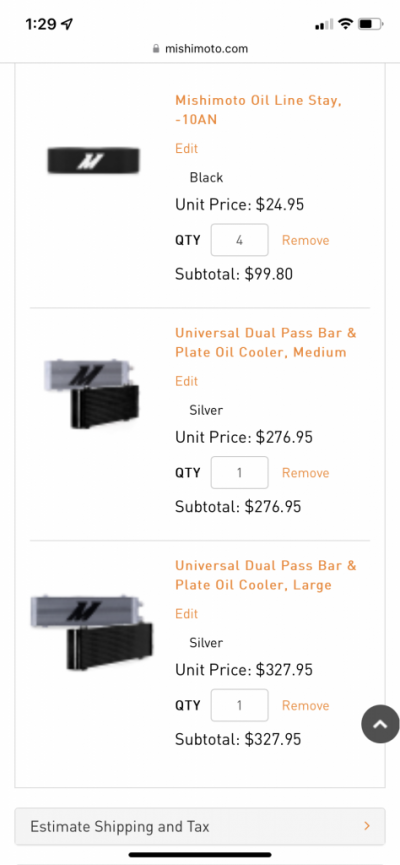

Here you go. Parts list of what I would get. This doesn’t include the -10 an hose or fittings. And I’ve listed a medium and a large oil cooler depending on your wants/needs. I would lean towards the large

just placed my order for this kit looks high quality.. thanks for the link bro.

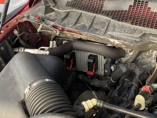

I would look into insulating the ac lines and swap to the v6 fan. The v6 fan is an upgrade over the stock ac fan by quite a bit since it’s shrouded and will help cool the ac better as well. Insulating the ac lines will help the ac run more efficiently and my vent temps dropped about 2 or 3 degrees after insulating the ac lines.
[QUOTE="crazykid1994, post: 26678.... trust me the stock fan is a beast. [/QUOTE]
very nice i haven't insulated the line yet will take alook at it tonight altho my ac is a fridge freezer rite now waaaaaay colder than stock which was very cold to begin with. i also blocked of the heater hose going into the cabin for an even colder ac.. installed a shut off valve on that hose in your pic going to the heater core. easy 10 minute mod
oh yeh i do have the stock shroud on i just removed the clutch fan kept everything else. its working great so far..
