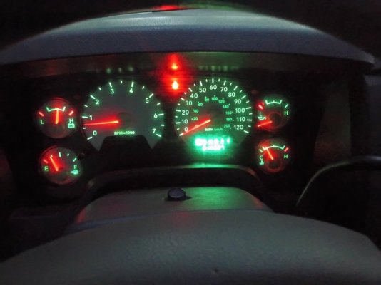

5163.jpgmy oil pressure gauge is like this. 2007 with214k. New sending unit. No excessive sludge buildup, no check gauge light, good pressure on manual gauge set. What could this be. Any help would be great. Top end of engine is new along with water pump radiator and all new front suspension.

View attachment 583840my oil pressure gauge is like this. 2007 with214k. New sending unit. No excessive sludge buildup, no check gauge light, good pressure on manual gauge set. What could this be. Any help would be great. Top end of engine is new along with water pump radiator and all new front suspension.
Truck is 20 years old,might be easier to stick an aftermarket mechanical gauge in it,then find and fix the issue with the factory gauge.It's also more accurate

Looks like your gauge is mechanically broken. I think there should be a pin that keeps the needle from moving below zero.

Did this test below the oil pressure gauge did not move all the others did. So I know the problem now.
Run a Gauge Sweep Test: Many vehicles have a built-in diagnostic test. Try turning the key to the "on" position while holding the trip odometer button. This will force the cluster needles to sweep back and forth and test the lights, which helps determine if the physical gauges still work.
