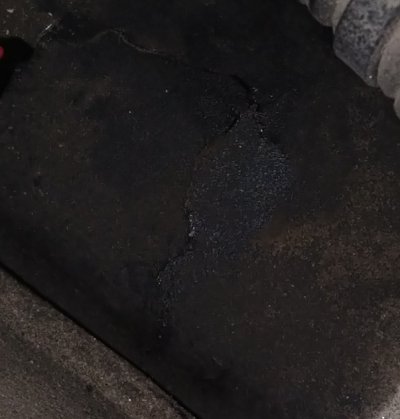

Found it.... The passenger side valve cover has a crack in it. That's never good :(
Looks like a broken valve spring. My mechanic is looking at it... IMG_20230209_151315.jpgIMG_20230209_153747.jpg
