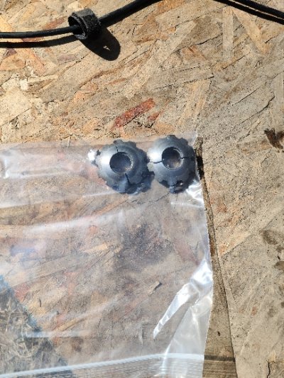

Some reason pics don't want to upload. 3f569a5ced098f321f026d479eb8bc52.jpg20c7634df900047090e4814cd2f5f15a.jpg
