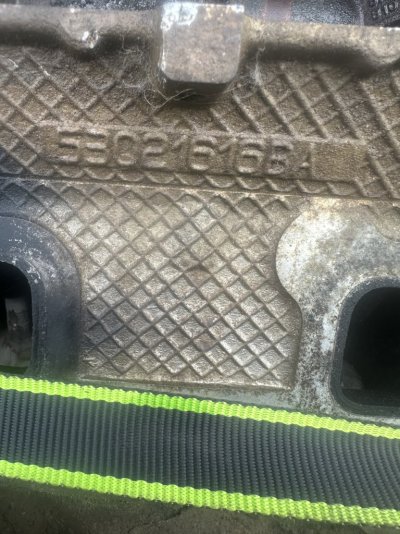

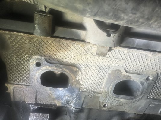

I acquired the motor as I want the passenger side head…are these 2 heads interchangeable?, they look identical but the serial number is slightly different letters

As long as it's an 09 and newer engine,the heads will work on your 16.Pull the intake,if it has the VVT solenoid at the front of the engine,it's an 09 and newer engine,no VVT solenoid,means it's the older 08 and earlier engine
