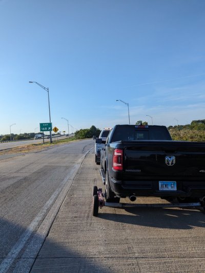

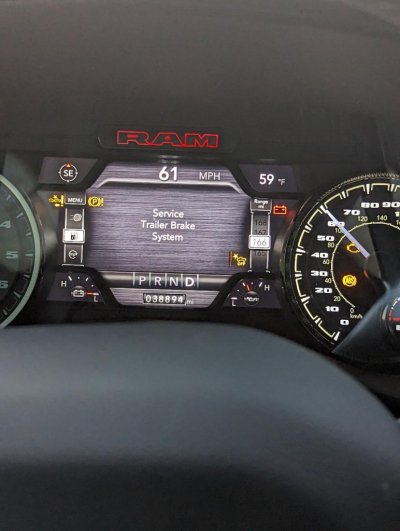

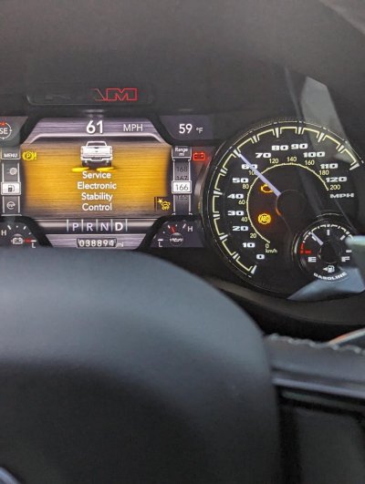

My truck did the same thing as bavelsgard. What's worse is that I notified the dealer the day before that the check engine light came. Left me stranded about 150 miles from home and Dodge basically told me that I was on my own as far as transportation and that they couldn't get to it for about 2 weeks. Had to rent a car and then take the bus home. Not sure if this truck will stay around. It's the second battery charging problem in 6 months.
