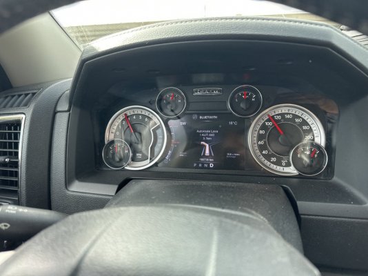

Ive been trying to turn of the cluster turn by turn nav, but there doesn’t seem to be an option for it like other years I was wondering if its possible?

There is an option with AlfaOBD to turn off turn by turn prompts in the cluster but I think their is an option in the radio too? Maybe in the NAV app itself?

I’ve checked every setting in the nav menu and it seems to not have the option, is alphaOBD my only option? and if I get the software is there any external things I would need to buy to make it work? or can I use it without some sort of connector, to change the turn by turn nav?

If memory serves me correctly, the settings isn't in the navigation section but the regular radio settings. I'll have to check later today or tomorrow unless some beats me to checking.

ive spent hours combing over the settings, if you can find it that would be appreciated but I cant seem to

In the radio under: Settings>Display
For clarification, this is on a UAQ radio that is installed in a 2015 truck that originally came with the 8.4AN radio (factory navigation). The radio options though are read from the BCM.
