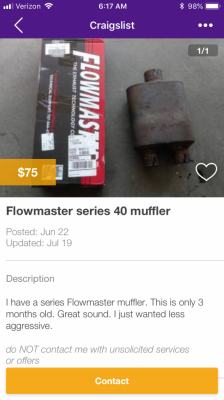

7795FB7E-ADE2-42DC-9268-1EDCC6B26AAD.png These flowmasters, do they rust easy? I live in the rust belt.

I put a 40 series on my 2003 when it was new and it is still running strong on the truck that my friend has now. Still sounds good too.
