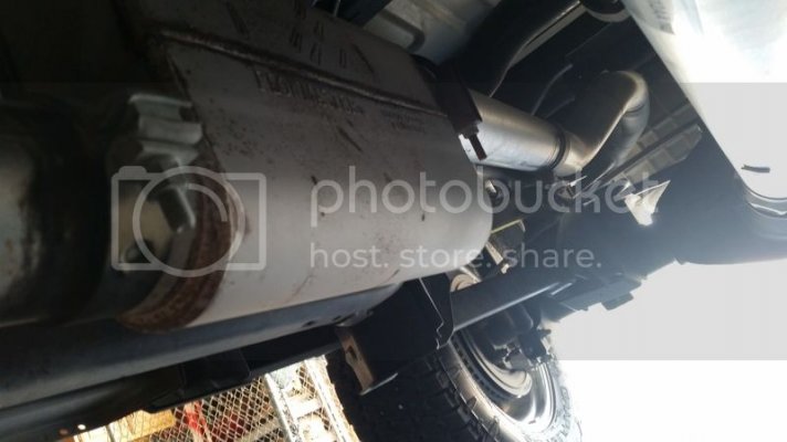

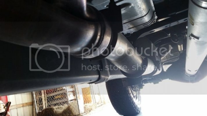

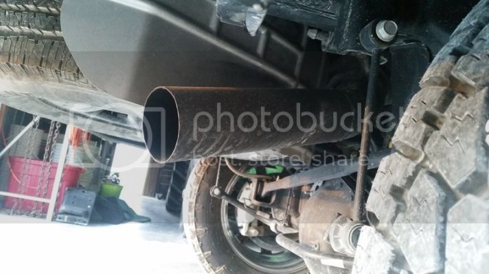

I just installed a Magnaflow on my with a resonator delete. I copied this install except that my exhaust guy replaced the resonator with a piece of straight pipe and welded the stock exhaust tip back on so it exits at the stock location,
This is mine on my 2015 6.4L
I used the stock front section, added the Flowmaster and a 3.5" straight pipe to make up the length of the stock muffler. Then I used the factory over the axle pipe after cutting out the resonator. Welded in a straight 3.5" pipe the length of the resonator and painted that flat black with high temp paint. It now blends in and sounds great to me.
It is very quiet inside but it does have some drone at 1500 rpm. Altogether a good mod from my perspective.
