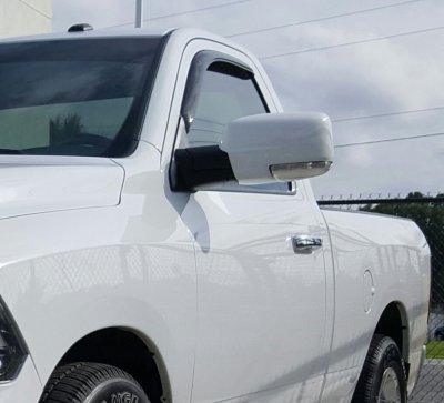

Is it possible to put side mirrors from a Sport on an Express and make the turn signal/puddle light work?

You just need to buy them and add two sales codes. Some one will be along shortly to tell you what they are, because I can't remember.

Sales codes are LEB and LEC. You need to make sure the mirrors are from a 13 or newer as the outside temp sensor is mounted in the mirror on these years.

The is lights are LEDs and I'm not 100% sure but I don't think u can just buy the light I think u have to buy the whole mirror ( I did the upgrade on my express I had the dealer active the puddle light with Leb and lec sales code) the mirrors are plug and play other then that if u get a set with power fold u will need to change out ur buttons so u can have that feature as well

Smoooth..... :D
