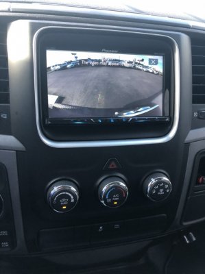

I am kicking around the idea to upgrade my stock radio. I have an 18 Express with the 5" (?) headunit now.
Options I am thinking about:
1) Double Din aftermarket radio
2) factory 8.4 radio.
Main things I would like to add- Navigation and bigger display.
Things I have now and need to keep - Backup camera, hands-free, Sirius.
Now, I know there are ways to do both, but I am unsure of what I would all need for both. Which is more cost effective/economical? Which is most beneficial in long run?
I was pretty experienced with working with stereos in the late 90s-early 2000s. I also was a mechanic in the Navy, so I can turn a wrench, so not scared to dig into something.
For resale, clean look, etc I am leaning towards the factory unit. But, then being more budget minded it seems like an aftermarket unit may be cheaper?
I plan on a small upgrade to the stock speakers and possibly a small amp/ 1 sub setup, probably a 10".
is your backup camera in the mirror or the head unit? I want to upgrade my radio as well and have my video moved down to the radio.

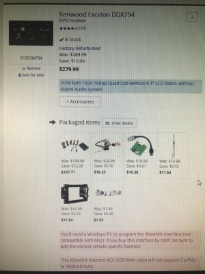

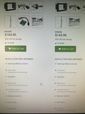

Was looking in Crutchfield and came up with this.
What else will I need and where should I look?
RedFalcon
Apr 20, 2015
184
93
Katy, TX
I believe that pretty much covers everything you need. I see the Maestro, the wiring harness, the usb hub replacement, radio adapter, dash kit, and screws.
You could use that as your part list and try and shop around to find cheaper prices which shouldn't be too difficult. But if you don't mind paying a little more for one stop shopping, that should take care of it

You’ll need an XM receiver if you want to keep satellite radio.
RedFalcon
Apr 20, 2015
184
93
Katy, TX
I believe he means you need an adapter to keep xm radio
