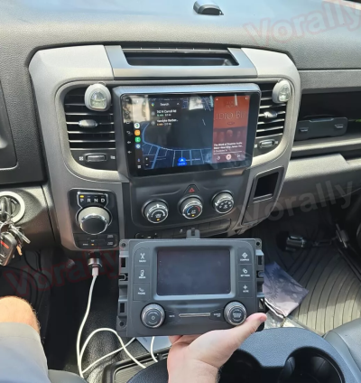

If you want aftermarket go to Crutchfield.com for options. Others also like certain Chinese aftermarket Android Headunits and are very satisfied...like this :
And still others (myself included) opt for the factory 8.4 radios as detailed in this thread...

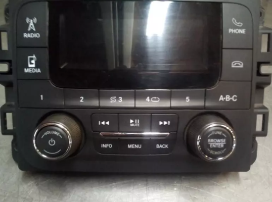

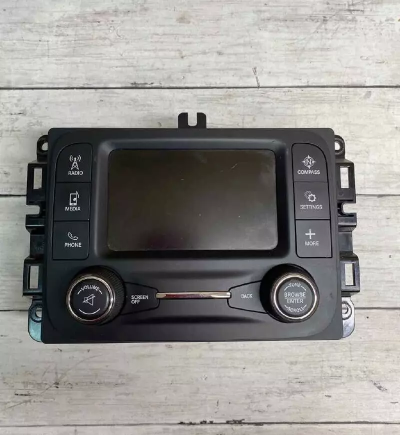

I believe that you either have the RA 3 or RA 5 radio
If you do not have a Touch Screen
It may be this radio, that you have
Any stock radio with Navigation would need
not only a different larger radio, but the Radio Bezel needs to be replaced also
you can see the size difference

I upgraded my basic radio to the 8.4, needed the radio, a new bezel (got mine with volume control at Infotainment, the wiring harness (from M²Mods) and the steering wheel controls (from Benny at All Mopar Parts in vendor section. Use a 2019 or higher 8.4 from a 4th Gen (classic) if you go factory route. The 2018s had a problem with delamination although any 2018 units now have probably been fixed by now or do t have the problem. Using 2018 and a over UAS gets you Android Auto and Car Play to allow you to do things like use your phone maps instead of the out of date software in the unit's with maps (known as UAQ). Also, you would need to add an antenna for the built in GPS.
